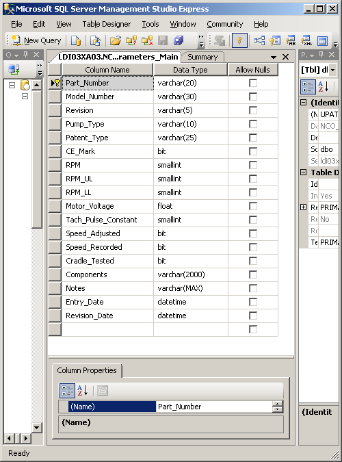

My table appears as shown below.  The field that is Data Type  varchar(2000) was originally varchar(MAX) like the one below it.  When both are (MAX) the first field returns no characters at all.  When I change the first one to (2000) then it returns the data accordingly.

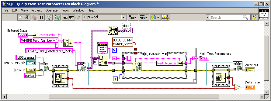

I am using pretty uncomplicated code as shown below also.  I am looking at the indicator straight out of the databse call so this info is sinply not even getting to LV.  I have run in highlight mode and no errors, no warnings. It simply returns no data for that field.  I tried feeding the table names into the Select Data and no change. I tried different rows (part numbers in my case) and no change.  I deleted the field in the table and re-created it from scratch and repopulated it and no change.
Since this didn't affect the data that came into my MS Access front end, I can only think at this point there is something in the LV database vi's that is causing it. While I have a workaround that will work fine for me on this project, there may be a time when I need multiple (MAX) fields and I want to eventually figure out what might be causing it.

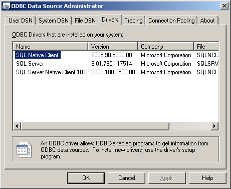

I think it's a limitation of the ODBC driver for MSSQL rather than a fault with LabVIEW. Which ODBC driver are you using?
The following google search seems to agree with me that certain versions of the MSSQL ODBC driver don't support varchar(max) fields properly (probably because it allocates a buffer or something to that effect): https://www.google.co.uk/webhp?sourceid=chrome-instant&ion=1&espv=2&ie=UTF-8#safe=off&q=odbc%20drive...
The solution seems to be to use the SQL Native Client driver instead.

I did run the query in the SQL management system.  No errors when they were both set to (MAX).   The OBDC Driver is a consideration I had not taken into account.  I looked and these are the drivers on my system currently.
Since I configured my initial DSN configuration using Access, I don't know which driver it used.  I can go back and create two alternate DSN configurations selecting the two client drivers respectively and try both and see what happens.
While I give this a try and report back, the fact that I am using the same DSN config for LV as I am for my Access front end, seems like if it was the driver, it would affect both.
Should be able to try it this afternoon.
