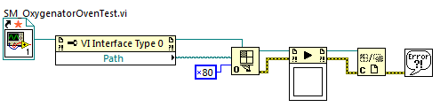

I had a look at your project and made the following change and it built/compiled:
I suspected the problem might have been that because you used the VI Name to open the VI reference that this became incorrect when built into the executable. The method I've shown above is how I usually use Static VI calls and this means that the VI is automatically included in the build specification, the paths just work and the VI type specifier always matches the connector pane.
I then went back and tried to make the smallest change possible - changing VI Name to Path but leaving both references, relinking to the SubVI but none of these worked. I wonder if it has something to do with having both references to the same VI? VI Name and VI Path both worked as soon as I made both VI references static.
This is obviously only suitable when you're launching one or more instances of the same VI rather than launching different VIs (that have the same connector pane / interface).
Anyway, the solution I have shown above should work but I'm unsure of exactly what it didn't like about having both (static and non-static) references to the same VI.

Sam Sharp's solution resolved my broken executable issues, and my executables all function properly now.
