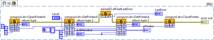

OK, I think I can duplicate what you're seeing, with the snippet below. For any level other than 3, GetLastError returns error 124, "The system call level is not correct." No idea what that means. With level set to 3, the first call returns error 122, "The data area passed to a system call is too small." which makes sense, and the second call succeeds. If your setup matches this, then I would say that you have properly configured the function calls from the LabVIEW side, and you need to figure out what parameters you need to set to OpenPrinter/AddPrinter to get the right system level, whatever that is.

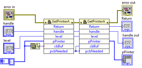

Both this sample and the sample Darin posted are almost exactly what my process is doing.
But for me, the return on the second GetPrinter is still 0.
My pcbNeeded for the first printer was 4544, but the pPrinter pointer returned an empty array out of the second GetPrinterA.
I am testing my default printer, which is a network printer.
I downreved my VI, attached, to 2012. Hopefully it works for you.

Try my code. It's a "snippet", meaning you can drag it directly onto a block diagram (or you might need to drag it to the desktop first, and then drag from there into a block diagram) and run it. Does it work for you? Compare the call library function configuration to yours.
I can't test your code properly without seeing how you're calling GetPrinter or AddPrinter to get the handle in the first place. One detail I noticed is that you should configure the Minimum Size of pPrinter to be cbBuf (in the call library configuration setup).
You might notice in my code I added a call to GetLastError so you can see what error occurred; you can look up the error codes on MSDN.

You did not follow my advice to set the minimum size of pPrinter to cpBuf in the parameters tab.  (BTW I show names in the CLFN).  You either have to initiliaze an array with sufficient size or use the minimum size setting.

Ah, I see. I overlooked that with my multitasking.
I made that correction and everything works now.
Both my VI and the snippet VI appear to work.
