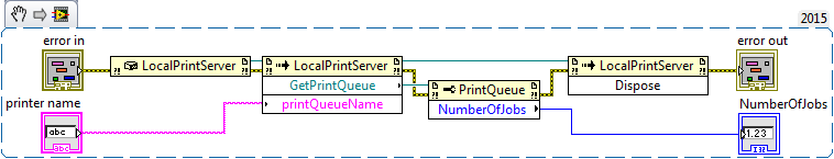

If you are doing this solely to get the number of jobs, you should try .NET:
