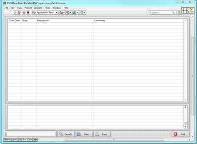

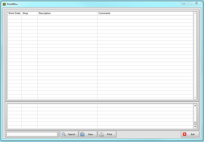

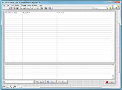

I have been having an issue (a mildly infuriating one) where my window size changes after running. See images
The window expands by the size of the scroll bars in the x and y axis. It only happens sporadically - I can't figure out a way to predict when it will happen or not.  I'll just be running/stopping the program and then bam! different front panel size.  I've also had it happen on multiple different machines with multiple different programs.  There was no code in any of the programs that resized the FP window.  I know I can force the runtime size with VI properties, but...

I gutted the linked vi (with notes on what was changed) and attached it if you want to try and reproduce it.  After some more playing around with it, I realized it is any time I first open the VI and run it.  It seemed random because the VI was part of a project and I was frequenly opening / closing / running etc.

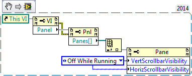

I added the following code in the initialization sequence and was able to do a few run without seeing the offset systematically.
