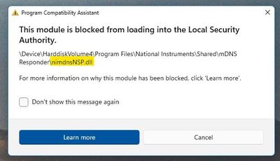

Windows 11 blocked nidnsNSP.dll from loading, do I care.
More on the saga of loading LV 2023Q3 on a windows 11 machine.  When I reboot, which has happened several times since I did the install, I get a message box that says that
. . . National Instruments]shared]mDNS Responder\nimdnsNSP.dll
Is blocked.  When I clicked on the learn more button it said.  "Core isolation is a security feature of Microsoft Windows that protects important core processes of Windows from malicious software by isolating them in memory. It does this by running those core processes in a virtualized environment. "
Google AI says the following.
"nimdnsNSP.dll" is a file associated with National Instruments software, specifically acting as a "Zeroconf Namespace Service Provider" which allows devices on a network to automatically discover each other without manual configuration, essentially enabling plug-and-play functionality for compatible NI devices; it is part of the "NI mDNS Responder" component within the NI software suite. "
I am using a lot of Ethernet devices and also am sharing data between computers so I suspect that this is important.
Next I guess I have to figure out how to get windows to allow the DLL to run rather than blocking it.
I am curious if others have seen this and what they did about it.
(45,261 Views)
I recently started seeing this pop up as well.
I am interested in the "solution" as well.

Update.  The pop up window shows up kind of randomly.  There were two instances of it on the screen this morning after the computer got left on overnight.

I just installed the x86 LabVIEW 2023 Q3 Patch 4 runtime installer and got that message after the install reboot.  This is a brand new computer that was just setup for me.  So I am looking into this as well.
Edition Windows 11 Pro
Version 24H2
Installed on ‎11/‎20/‎2024
OS build 26100.2454
Experience Windows Feature Experience Pack 1000.26100.36.0
(45,130 Views)

I sent an email to NI support and so far they just said to check with my IT department.  The funny thing is I ended up uninstalling the runtime and after installing it again I did not get the pop up.  So I will call it good at this point since it went away (for now).....
I have done this same runtime install on 5 other machines recently with no issues.  Must be gremlins!
EDIT:
Never mind, I just looked at the computer at it had the popup again.  Looks like I will be deleting the file.
