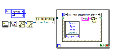

How do I register this as a user event?
This is what I have so far but it doesn't work.
You can't do it directly. You have to run a polling loop to monitor the keyboard state and you can generate a user event whenever that array changes. This loop can be in a subVI, but then you also need a way to stop it.
Edit: this refers specifically to these VIs. Windows does have hooks for keyboard events, but I don't think you can write the code to intercept those directly in LV, at least not as a system-wide hook.

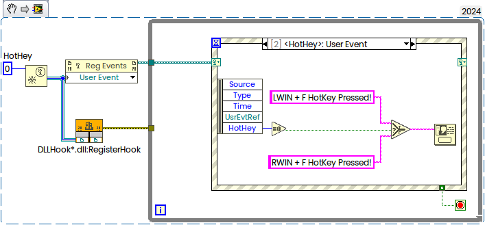

Block Diagram:

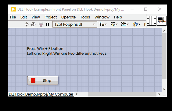

and works, also when focus not on LabVIEW's Front Panel:
But I'll not take any responsibilities for crashes or "side effects", use on own risk (I did this exercise long long time ago in the past, but unable to found 100% working solution).
Full source in the attachment, the DLL was built with latest NI CVI (could be easily ported to MSVC), the LabVIEW code downgraded to 2018, tested with x64 (2024Q3), should work in theory also with 32-bit (but wasn't tested).

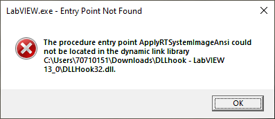

Do you know what does this error mean?
Message 9 of 21
(2,693 Views)
Try to download and install latest CVI Run-Time 2020:
LabWindows/CVI Runtime Download
If this will not help, then I can recompile DLL using Visual Studio 2022 instead of NI CVI 2020.
