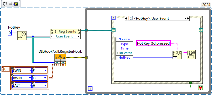

Anyway, quick change which I can made for you is the following:
Now array of modifiers and hot keys provided externally.
Technically LabVIEW's array of clusters passed to DLL like this:

DLL function is modified:
// Exported function
int RegisterHook(LVUserEventRef *LVevent, HotKeysHdl hot_keys)
	Keys_Amount = ((*hot_keys)->dimSize > MAX_HOT_KEYS) ? MAX_HOT_KEYS : (*hot_keys)->dimSize;
	for (int i = 0; i < Keys_Amount; i++){
		Modifiers[i] = (*hot_keys)->HotKey[i].Modifier;
		Keys[i] = (*hot_keys)->HotKey[i].Key;
	lvEvent = LVevent;
	return 0;
And how Hot key checked in callback:
__declspec(dllexport) LRESULT CALLBACK KeyboardEvent (int nCode, WPARAM wParam, LPARAM lParam)
	int hotkey = -1;
    if  ((nCode == HC_ACTION) && ((wParam == WM_SYSKEYDOWN) || (wParam == WM_KEYDOWN))) {
		KBDLLHOOKSTRUCT hooked_key = *((KBDLLHOOKSTRUCT*)lParam);
        int key = hooked_key.vkCode;
			if (key == Keys[i]){
				DWORD Mod_Key = GetAsyncKeyState(Modifiers[i]);
				if (Mod_Key){ hotkey = i; break; }
		if (hotkey >= 0 && lvEvent) PostLVUserEvent(*lvEvent, (void *)&hotkey); //Fire LV Event
    return CallNextHookEx(hKeyboardHook, nCode,wParam,lParam);
 (also please read suggestion from Rolf above, there is more elegant way to get this).
Please try from attachment.
Message 17 of 21
