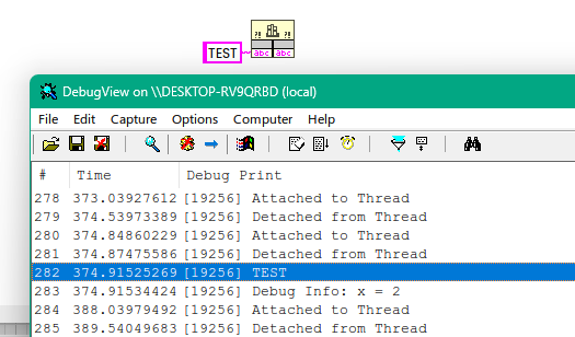

Then output shown in DebugView will be:
And you will be not blind at least. DebugView will capture all outputs from all windows processes, but you can apply filter if this annoying.

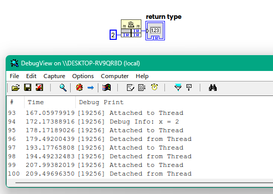

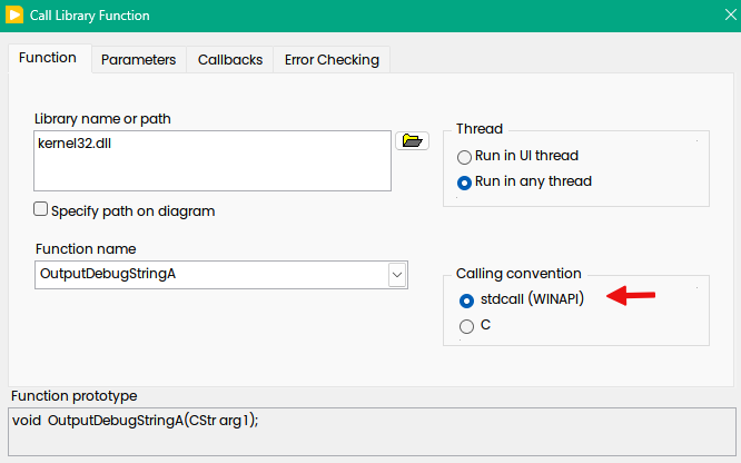

By the way, you can call this function directly from LabVIEW, sometimes its also useful (don't forget to switch to WinAPI calling convention):
and output will be here:

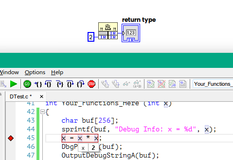

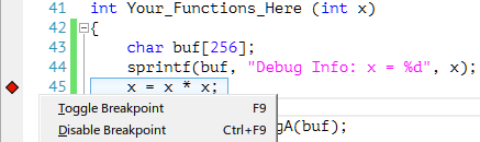

But the "classical" debug technique also will work with CVI and LabVIEW, then in CVI you will set breakpoint:

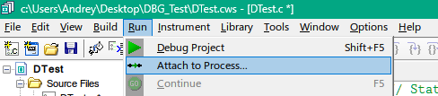

Then build Debug verision instead of release, then you can start LabVIEW and attach to that process from CVI:
and when you will call it from LabVIEW, the CVI will be stopped on the breakpoint:
So, you can debug you DLL (don't forget to build release after that).

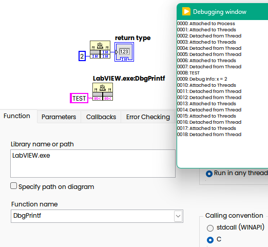

And just one more thing — in LabVIEW you have "embedded" debug console, you can call DbgPrintf() from LabVIEW.exe, like OutputDebugString from kernel, then output will appear in small window:
and this can be called from your DLL same way, of course:
