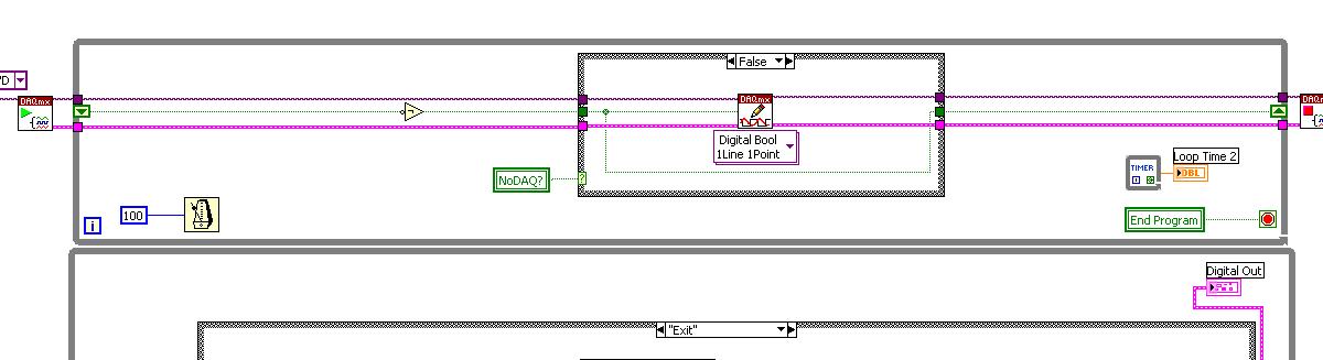

I have a USB-6009 running on Labview State Machine controlling 2 analog outputs and reading 2 analog inputs. There is also a file write in AI read state. After 2-3 hours into cycling(AI Read/AO Read States), program pops up with a generic file I/O error(6). Seems like the system is running out of resources. At this point if I try to start any windows program it will say not enough resources. I have the pictures attached for state machine cases.  I have a separate case for AI/AO Start Task(DAQ CONFIG). and a separate one for stop and clear(EXIT). I tried to start the task in AI read case but my loop time goes almost double. Out of this state machine I also have another while loop(watchdog) running at 100mS rate. Any ideas will be helpful.

could you attach the actual VI instead of some partial images? You are using lcoal variables and that's never a good sign.
