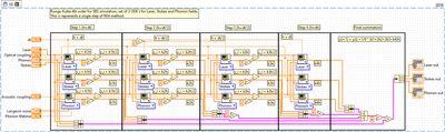

Here's the updated vi to bring everyone some joy - it's sequenceless.
I know it's outside of the scope of the original question, but if you don't mind answering another question: when I divide or multiply a complex variable by a double, it will always show the red coercion dot to bring my attention to that. Is it really worth manually putting a conversion to complex in such trivial case?
Message 15 of 24
(1,552 Views)
