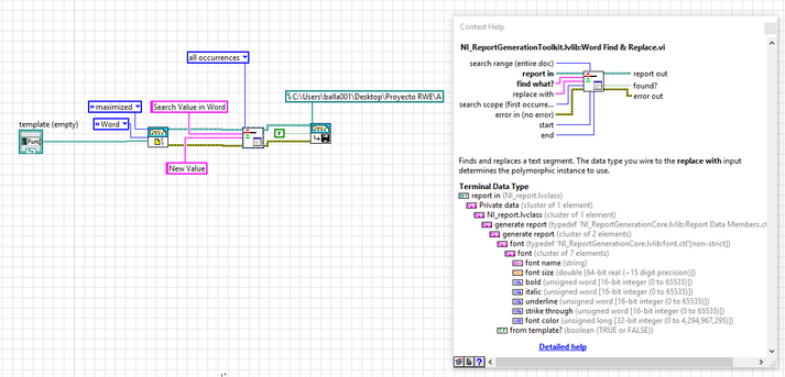

This is the code I have.

The ActiveX function uses the range of the document, and that doesn't cover headers and footers.
You can save a copy of that function, and modify it. It won't be trivial...
From the document, get all sections (sections property). Use Count to iterate over all items. For each section, you can get the headers and footers. For each header and footer, get the range and use the find on it...
So, definitely not trivial. And also no guarantees, I haven't tested this... It does seem the way to go, and possible.
