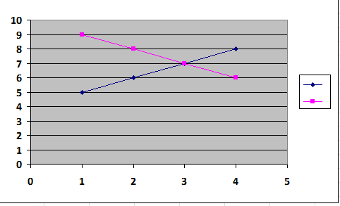

Try xlXYScatterLines for the graph type.  It looks like row 0 in your data array will be the x values and the following rows will be y values, with each row being a new plot.
aputman
(5,066 Views)
Accepted by topic author AnthonyMN
This code:
produces this graph
