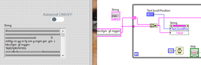

Neglect Block diagram in this above mentioned example.
My requirement is , my string Indicator will be keep on updating. So vertical scroll bar is required and when string indicator keeps on updating, scroll bar also automatically moving.
In order to avoid this, I have placed a Boolean switch to turn off/On this autoscrolling. Is it possible to control this automovement of string scrollbar by clicking on that Boolean control?
When Boolean ON, scroll bar should move automatically.
When Boolean OFF, scroll bar should not move automatically.

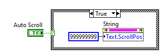

Seems like this is what you want. Put this inside your while loop.
(False case is empty)
