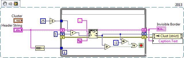

You can force the test to wrap by replacing a space with an EOL.  Here's a quick example.  Make sure your caption is set to Size To Text and you have no EOL characters in the text you want to use.
This just searches through the string and replaces the first space character after the character number specified with an EOL then does it again starting after the replacement.  It will keep going until it reaches the end of the string.

Kelly, tried the code but it does not appear to work correctly. Correct me if I'm wrong but you have set an initial offset of 25, however your code is then searching for a space after this offset. The problem with this (I believe) is that the offset point is completely static and would change depending on the string input.
For instance, if I typed "HelloWorldNiceToSeeYouNiceWeather Sunny" then your string would not wrap until after the word Weather. This string is still way to long for my cluster width. I do like the concept though and it does work in the right scenario but my strings will be completely random and the code must be able to handle any string input.

I had assumed the caption would be readable so should be wrapped at a word break.  You can change the constant to whatever value you want to accomplish that.  After I posted that I made it into a subVI that will take in a text string and an I32 and output a text string that is wrapped.  I still want to do some work on it, like checking for EOLs etc.
If you don't care about breaking in the middle of a word it's easy to simply insert an EOL every X number of characters to make the string wrap.

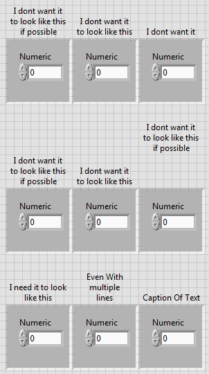

I probably should have explained a little better but as well as the caption wrapping (which now works) I need all the text to be flush with the top of the cluster for each cluster so visually they look correct, regardless of the number of lines. This is why I said I wanted to shift the text up, not down but I realise this was a little murky. Here is what I mean:
I have attached a modified VI to show this in action. If you run it, you will see that the text in both the caption and string indicator jumps to the top and I cannot see how to force it to the bottom which is the final piece of the puzzle as it works fine apart from this little quirk. I have also noticed that re-initialising all values to default doesn’t change the caption text and position; it retains the last set of written properties regardless whereas the string does revert to default. I will need this to happen as I change tests on the fly so I may end up sticking with string indicators.
Any idea how I can force the text position to the bottom?
