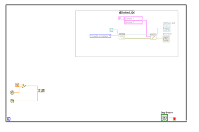

Hi, I need to write data to a TDMS file. The data is a single u8 1D array that I need to split into different data from two sensors, and then write them into the TDMS file. To accomplish this, I am using 2 random numbers with the "Build Array" function and attempting to write them to the TDMS file. However, my problem is that I am not sure how to save all the random numbers from each index and then write them as a 2D array in the TDMS file.
I have tried some of the examples that I found in the forum, but none of them worked the way I wanted. For example, my 1D array has 2 rows, where the first row contains values 10-20, and the second row contains values 50-70, and so on. In my TDMS file, I would like to see Channel 1 displaying the values 10-50, and Channel 2 displaying the values 20-70. I want to display the data in something like this:
I know I need to use a for loop but I can't make it works, here is my vi that I'm using to try things:

Hi A.,
Provide your data as a 2D array for TDMSWrite: each row will be data of one channel…
(Or use a 1D array of waveforms.)

Ok, next try, I did this, this is easy and it is what I need, the problem is, I dont know how many times the for loop needs to go, what can I do to have the same result using the same data input (the 2 random numbers in this case) and running the for loop until I stop getting data.

Hi A.,
Generic programming rule: When you don't know the number of iterations before starting a loop then you should use a WHILE loop instead of a FOR loop…

Then what can I do to write the TDMS, I don't care if I need to use for, while or whatever, I just need to know how can I write each index of my u8 array in 1 different channel and keep writting.
