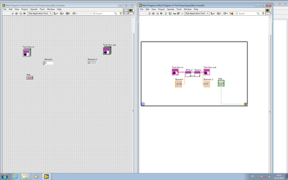

I have attached a project. There are 3 VIs, 2 VIs under the class Test Class, i.e Write and Read. A numeric control in write and an numeric indicator in read. Then these sub vis are then copied into the main project, which is outside the class where I wired a numeric control to the write vi and numeric indicator from the read vi. Now I run the program continuously using while loop. Now when I enter a value in write I need the read to show the values. But nothing is happen. I am doing this as a test to another project where I enter values in one point and I get the values at another point during a special case. For that to work, I need to make this work first. Also please I donot want to use functional global variables. It has to be object oriented programming and class because I am trying to understand oop. I have done a some reading and I thought i know how oop works and now I know i dont know anything. Kindly do help me. Thanks in advance.

I see 2 main issues:
1. You are not using the output of the Write.vi.  LabVIEW uses a By Value OOP.  So all that matters is the data on the wire.  Since you are reading the value of the object before the write was done, you will get the "old" value and the "new" value is never used.
2. You are overwriting your value in the Read.vi.  That makes absolutely NO sense.  The Read.vi should only be reading the value.

write and read.pngI know about programming this way. I have done it and got the output. So what you are telling me is that I cannot use these 2 VIs in 2 different position. I need to connect the class output of write to read. So two use the same values in 2 different places, the only way possible is a functional global variable. Is that right?
Message 4 of 11
