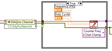

Hey Kevin,
The error that you are getting is expected in the way that you are programming your application. To see an alternate way to implement the property node and avoid the error, please reference the Developer Zone Example Program: Change Counter Output Frequency on the Fly.
Within this example, you will find this implementation:
I recommend you place this into your code and see if that is able to resolve the error that you are seeing.
In your program, you also don't need the DAQmx Property and the DAQmx Write when setting the Duty Cycle and Frequency. You would just need the DAQmx Write to set these attributes.
Also, as a side note, I noticed in your code that you never clear the task. Be sure to end the application with a DAQmx Clear Task.vi. I didn't see one in your program.

Hi Sarah,
I tried your recommended code and it works great.
Thanks for your help.
Kevin.
