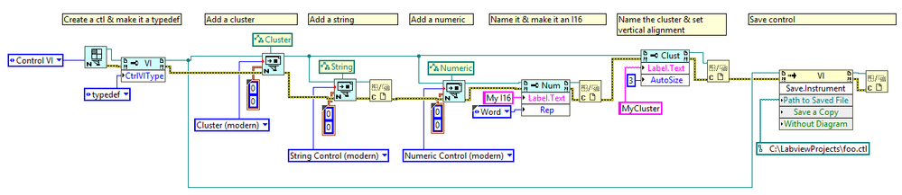

It is possible to programmatically generate entire VIs using VI Scripting. (Enabled in Tools > Options > VI Server > VI Scripting)
This VI will generate a typedef control containing a cluster with a string and an I16:
Since you can read information about column names and data types of a given database table, you can programmatically generate clusters matching the table, and so don't have to do this by hand.
I think it is not possible to use this control directly in the VI that created it. However, it might be possible to script an other VI, which uses the just  created control to cast the data read from the DB to labview, edit it, and then writes it back to the DB. This VI could be loaded into a Subpanel of the current VI. But I did not test this.
