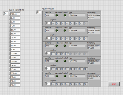

I am able to read these messages on LabVIEW - through an XNET read frame CAN in stream session. Here is a snippet of the front panel of the vi after I ran it for a few seconds. You will notice that the input frames display the x61x messages from nodes such as vcu, ipcimVie and becmA123.
The issue is that I cannot read the frames that I created on LabVIEW. If I disconnect other CAN enabled devices, and only have the LabVIEW vi running, the input frame array is completely blank.
Would anyone happen to know why I can read frames from external nodes, but not the ones that I wrote through LabVIEW even though they are being transmitted to the CAN bus?

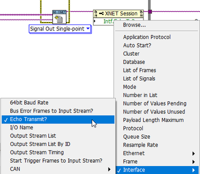

try to set Echo Transmit to True:

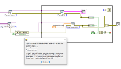

Thank you for your feedback.

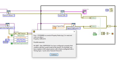

I set the eco transmit to true but it is resulting in the following error.
I tried setting some other properties too to help resolve the error but it's still not working.
Would you happen to know what is going wrong here?
