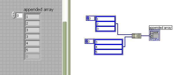

xyq102296 wrote:
I write a For loop for my labview, so here my question is Write to Measurement File read out like
0.000000               147.270000
1.000000               147.470000
2.000000               146.780000
3.000000               1.384000
4.000000               1.399000
5.000000               1.360000
can I change it into one row , so that new information come in, I can compare them in the same column , it's easier for me to see the difference.
Do you mean like this?
Message 8 of 12
(4,866 Views)
