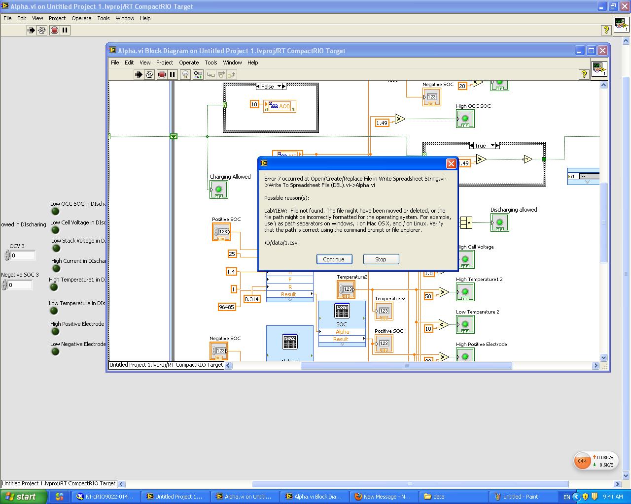

After the last post i find out when I try to write to spreadsheet under cRio, this happen, but when i run on my computer it work well.
Does anyone know how to fix it?

Hello niukasu,
How are you specifying the location for the spreadsheet file - is it preconfigured within the express VI? From a string or file path constant?  Dynamically generated? What model cRIO is this- RT controllers do not typically have a 😧 drive.  This KnowledgeBase article might help you determine the file path format required:

Hi niukasu,
the cRIO CANNOT access your PC's harddrive! It's a stand-alone computer!
There are examples coming with LabVIEW that show how to transfer data from cRIO (target) to PC (host). Use them!

To sort of repeat what GerdW already stated, the cRIO has it's own hard drive that it accesses.  You need to think of the cRIO as a separate computer.  With that in mind, think about how you share files amonst computers.  The easiest is to setup a shared folder.  Other computers can then access that folder with a network address.  The cRIO needs the network address of that shared folder in order to read from or write to it.

How to open the spreadsheet files saved in cRio by excel in computer?
(3,047 Views)
You need to copy the file to your computer somehow.  If you saved the file on the cRIO, then you can FTP the file to your computer.
