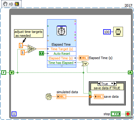

Hi MSK,
no need for one more loop. And no need for your inner While loop!
All you need is to use ElapsedTime together with an additional shift register. Keep the state of the "save? condition in the shift register.
When state is FALSE you have ElapsedTime to wait for 59min, when state is TRUE you have a wait target of 1min.
Change/negate the state when the time has elapsed…

Hi MSK,
the problem is that I don't understand how to use the shift register to realize this code because I never used LabVIEW like this before.
Then you should take those FREE online resources offered to you to learn LabVIEW.
See at the top of this LabVIEW board for "Training resources"!
If you don't mind, could you show me the example?
I don't mind:
(Using XOR to negate the boolean condition when time has elapsed. I love boolean logic operations…)
