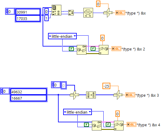

Nothing to do with your original problem, but you can make your conversions a bit simpler, less operations. See below:

Nice, I could have done with that at the start. I have added some tags so that others can find it.

Glad to help. Note that those functions, along with your string conversion can handle arrays directly, not need to put in a loop like your example.
