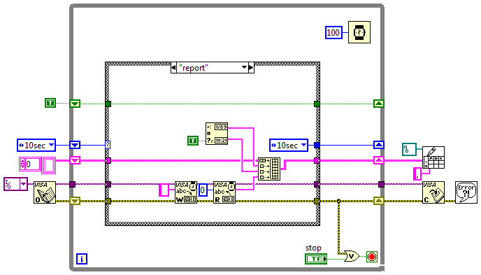

I have data from a temp and a humidity sensor that I'd like to write to a delimited file. Ideally a new line of time stamped data would be written every 10 seconds (haven't attempted the 10 second interval part yet). I'm not sure how to get the temp and humidity out of the two while loops and into a file. The attached vi is what I have so far. Please forgive me if I'm missing something fundamental. I've looked through lots of posts with example code in LabVIEW forum with no luck.

this might help you, havent tested it..but you will have to modify to your needs Smiley Wink
statemachine w elapsed timer set for 10secs, after timed out goto report out (write, read and insert into array). stop vi and write to file

Thanks. I like the state machine setup. I modified your example and can see that the 'report' state is firing every 10 seconds, but it is not writing all the way out to the file. Attached screenshot shows two probes placed 1) outside the while loop and 2) outside the case. Probe 2 gets timestamp and temperatures, but probe 1 says Not Executed. Book1.xlsx

Of course it's not executed. It will only execute after you press stop and exit the while loop. Basic data flow.

remove shift register and use indexing for the tunnel (after probe 2) . one more thing why you are using serial write vi before serial read, do you need to send some thing in return of which you get data received?

Do NOT remove the shift register.
