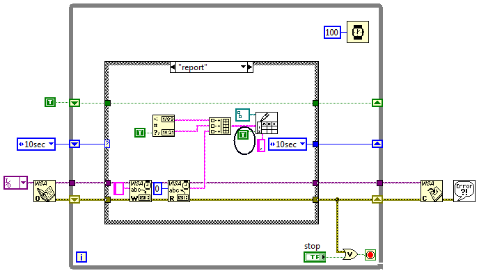

I now see that it writes to the file after the stop button is pressed. I need to write to the file itself every 10 seconds. Can you point me in a direction to achieve this? I see in your next post that you say not to move the shift register.
Message 12 of 20
(1,956 Views)
To write to the file every 10 seconds is simply a matter of moving the write to file processes that are outside of the while loop into the internal of the case structure, so that when the "Report" case is called the data is written to the file. If you were going to do this i might also suggest having the data flushed to the file or closing the file after every "Report" case as this will help to prevent the loss of large amounts of data if the program fails to close properly.
Message 13 of 20
(1,952 Views)
as mentioned previously....also set append to "T". I think its better to write to the file after the vi stops and put an indicator on the "data" shift register array to see the updates....IMHO
Message 14 of 20
(1,948 Views)
Ooooh, This is very close to working...
Last post from apok is working for a single sensor except for one small issue. There's an extra carriage return being written to the file. Screenshot attached (question about screenshots later). I believe the first CR is coming from from the temp sensor and the extra CR is part of the Write to Spreadsheet File.vi or vice versa. Maybe I can strip the two right most characters off the string from the temp sensor.
As for adding the other sensor, I'm going to try adding com4 outside the while loop, placing its respective read/write inside the 'report' case, and change the build array to accomadate another element.
