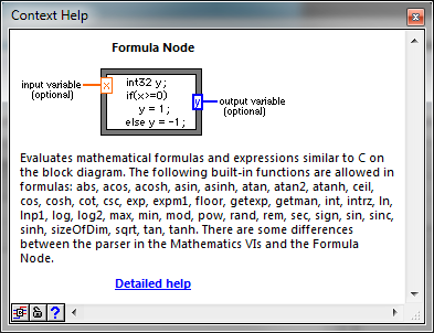

You can use formula node.

c is a compiled language, not an interpreted one.  The formula node linked uses a "c like" syntax, but is NOT c.  In order for c to actually be called from the block diagram, LabVIEW would need to contain an entire c compiler... and then basically repeatedly generate a dll (which you said you don't want to use) each time the vi was recompiled - which LabVIEW does almost constantly in the background as you're working in that vi.
Thank you, I tried it previously but it is only limited for mathematical operations, if conditions and repetition loops.
