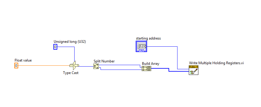

You need to create 2 U16 values with respect to the float values and then write it to the plc. BElow is a reference image for you.

You can typecast the float to a 1-D array of U16.
The one thing you may have to watch out for is if you need most significant or least significant word first.  If it is wrong, you may have to swap the U16 elements.

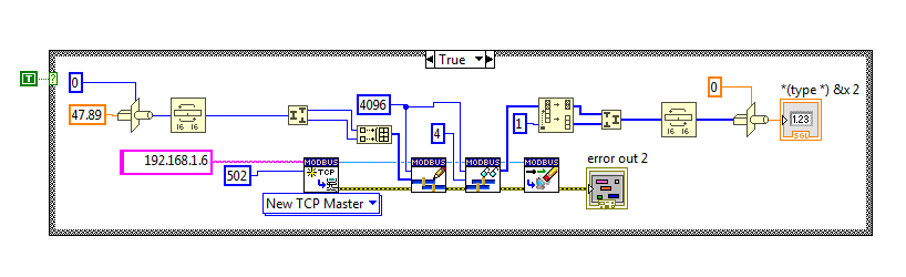

Thank you Kartik. I tried as suggested however I am getting 2.819 value on PLC side when I pass 20.47 through LV. Please refer attached vi for your reference.
Even when I tried reading float value from PLC using exact reverse way of write code, I am getting different value on LV side.

Thanks Raven. As suggested I have swapped hi and lo values in vi attached above but no luck. I am getting different value on PLC side.

You are writing the values correctly but the problem is when your read. You are writing a double float and while reading you are reading it in float thats why you are getting that value (2.819). Upload your vi where you read it.

I am getting 2.819 on PLC side. Please refer attached image.

Hello All,
Have gone through couple of more blogs and modified the code. It worked. Now I am able to write the exact value to PLC and also can read the written value from PLC to LV. Attached the vi for reference.
Thank you Kartik and Raven for the help. Appreciated.
https://knowledge.ni.com/KnowledgeArticleDetails?id=kA00Z0000019O2SSAU
image.pngimage.png Thank you.
