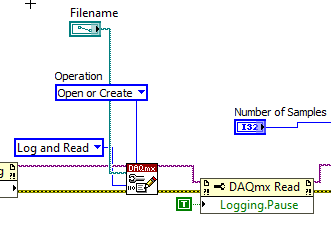

Here is a quick mod to your program.
  1. Your modules are in the same chassis, put them in the same task.
  2. Use the logging feature.
  3. Move the DAQ assistants to another loop, they are sending pulses. I never use DAQ assistant so not sure how it works, but its says they are sending highs and lows for 15s. How is your loop for acquisition supposed to run at 100ms if these are running at 15s?
EDIT: Set to Log and Read, should have been a constant not a control, like below
