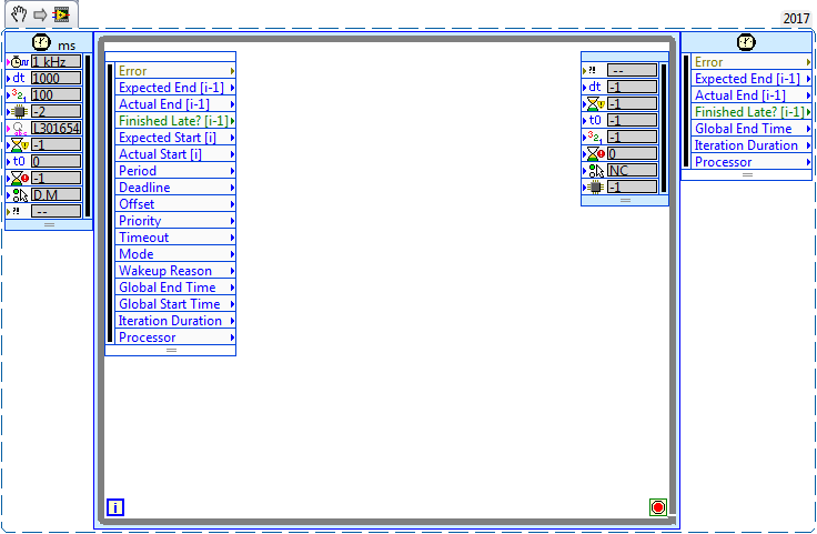

Right-click on the left or right borders of the timed structure to show the data nodes.  These can be expanded to show additional available data.  Fully populated, a timed loop structure looks like this:
Timed Loop with data nodes shown and expandedTimed Loop with data nodes shown and expanded
 40 MHz is the clock rate of the FPGA chip.  This represents the maximum possible resolution of your loop timing, but it is unlikely that you will actually be able to execute code that performs I/O within a single tick at 40 MHz.  Double-click the timed structure to configure it if you're not using the dynamic inputs.  Loop timing period will be one of the settings.  What hardware are you using?  On a CompactRIO target, for example, each type of C-series module will have its own specifications for supported sample rate or output update rate.  Running your FPGA loop faster than these specified values offers no benefit.  As I use many different types of I/O modules, I generally create a separate loop for each one, and run it at the maximum rate supported by the module for full channel complement update.  That way, when I read from FPGA I/O nodes in my RT code, I always have the latest values available, without attempting unnecessary reads, and I can set the RT timed loop to a period appropriate for what I'm trying to do. I might set the hardware output loop on the FPGA to my desired PWM frequency, but run the RT loop a lot slower if I'm only passing a duty cycle % to the FPGA, for example.
