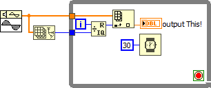

How many points are in one period of the waveform? I tend to generate a waveform once and then loop through the indexes (e.g. using the remainder of dividing the iteration could by N of the wave using quotient and remainder), thus simplifying the inner code as follows.

Thanks it solved 50% of my issue .
I am using a PC , one sample point at 30ms .
