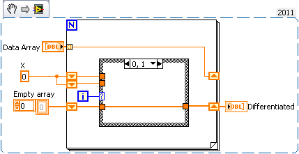

Thanks Anand.
I actually need to find out the difference in the values measured , as in x2-x1.. x3-x2. So thought of doing in Excel only as I could not find a better way in Labview as I m looping it  . Pretty new to Labview..So struggling Smiley Sad
(3,435 Views)
Accepted by topic author shubhi
For doing this you do not need a file. Check the attached example I guess this would work
