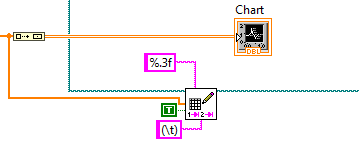

Thanks that worked but the delimiter doesnt seem to work? tried a few combinations of (\t)

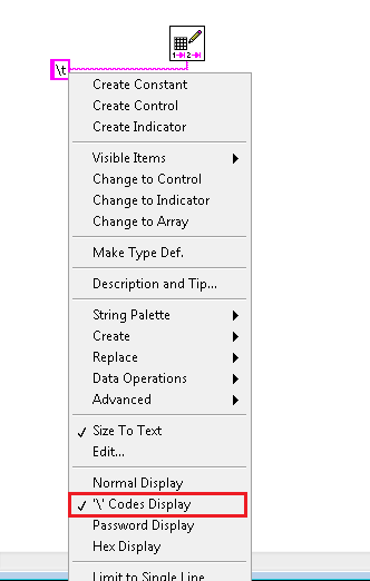

Have you tried terminal's default value? You can try creating the default value constant via right-click menu(Create >> Constant). Then you'll see '\t' under the string's code display mode.
-Tianbin

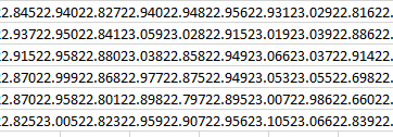

Hi, Ive tried that but now i just get this instead? the file is a csv if that makes any difference
Message 6 of 18
(10,579 Views)
Accepted by topic author newman3108
Exactly, the .csv file is the difference.  For .csv file, you should just use comma(',') instead of '\t' as delimiter.  I tried that the '\t' delimiter works well for .xlsx and .xls file formats.
