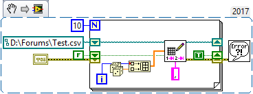

Well, by looking at the "code-you-failed-to-post", I can "make a guess" at your error.  Assuming you are starting with an empty file (i.e. your Program is supposed to generate a new file, writing one line per loop and therefore creating an N-line .CSV file when you loop N times), I'll guess you didn't use a Shift Register to handle the Append to File input.  Since you are using LabVIEW NXG, which I haven't installed (and which I'm guessing many other Forum users aren't using), I'll allow "pictures" (LabVIEW Snippets) to pass VIs back and forth.  Here's how I'd do it:
Make CSV.viMake CSV.viand here's what it might produce (as a text file):Test.csvTest.csv

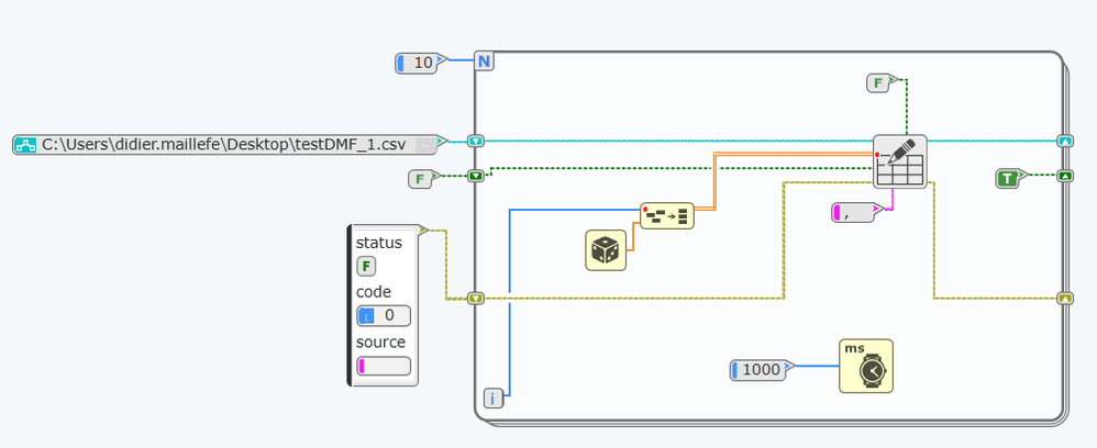

You're right that I did not use a shift register in my tests. Honestly, I don't see how it çan be useful on the "append to file" input as it simply means false on the first iteration and true thereafter.
Anyhow, I tried to replicate your example on LabVIEW NXG and it still does not work: only the last line is présent in the file.
For some reason, I cannot append the .gvi file, so here is the image of my diagram
Message 12 of 18
(2,143 Views)

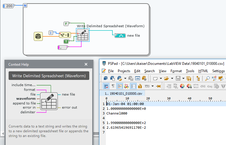

Unfortunately Bob's explanation is only correct for LabVIEW "Current Gen". I tested the functionality of Write Delimited Spreadsheet in NXG and found that it differs for NXG.
The Write Delimited Spreadsheet node in NXG is a high-level file access VI that opens a text file, writes data into it, then closes it. As it writes additional header information, it does not append data to an existing file, but replaces the whole file every time. I did not find a difference in behavior using false or true for "append to file".

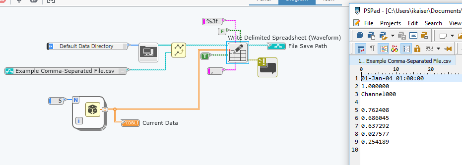

Note: I found some more about the NXG functionality. I used a shipped example VI. Functionality is similar to Didier's code. Wiring a 1D array, the function is labeled "Write Delimited Spreadsheet (Waveform)", and seems to ignore the wish to append data. I ran the gvi multiple times before taking the screenshot:

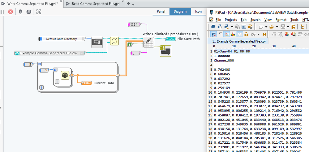

Wiring a 2D array however, the function is labeled "Write Delimited Spreadsheet (DBL)", and works as expected. Please note that the first lines of the file are from the previously executed 1D array test:

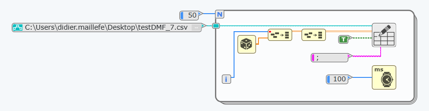

Accidentally, as I was playing again with the "Write delimited Spreadsheet" node, I notices that the code was doing its job perfectly when the data is presented as a 2D table as in the example below.
Then the "Append to file" makes the différence when checked.
I still think it is a shame that it does not work with a single value or a 1D table without warning
