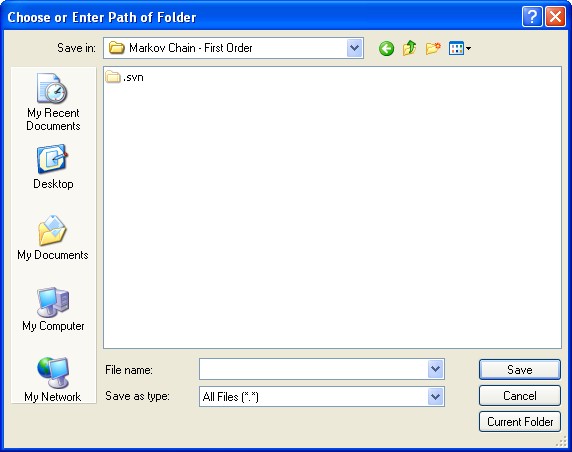

Okay, I've gotten the program almost to where I want it to be, but I am having one problem. Whenever I start running the program, the prompt asks the user for what folder to store the data into, which is correct, but then it asks for a file name, which is not correct. I have already named each of the 12 files, and I want the user only to choose the folder the data is stored into. I have opened up the menu for the Prompt Express VI, and made sure that the folder option is the only thing selected. What is causing this problem? Also, I would like to name the columns in the data files, only once at the top, so that it is easier for the person doing the data analysis.  How do I do this with the Concatenate Strings?
(3,709 Views)
The File Dialog seems to work fine for me.  I ran it and got this:
It says shoose or enter path of folder. It will not let me select files. There is a file name and 'save' button, which would make new files, but there is also a button that says 'Current Folder'
A better way to do this would be to use the 'Current VI's Path' VI, use a strip path to take the name of the VI off of it, and then programmatically build the path to the folder you want to write in, since you stated that you have the files already created.
