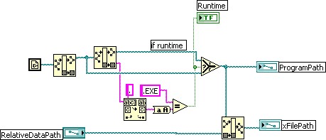

Norbert
Actually mine is a more flexible in that it does not depend starting with VI path. It works by repeatedly striping the path until a folder is found.
Yair posted some code that illustrates the idea in this thread.
My re-use code is very similar to the While loop but with different checks and error checking thrown in for good measure.
Ben

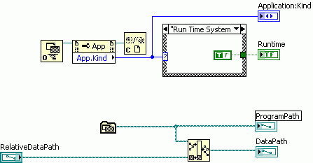

Norbert, Daniel and all
Using the switch "Use LabVIEW 8.x File Layout" solves my problem.
Attached is the vi, that does not work without this switch.
This very old VI (worked from LV6.x til 8.2.1) also detects, if it is called out of an *.exe and activates the "Runtime" boolean.
Origin of the *.exe:
F:\Projekte\RFbeam_DT1\DT1_LabVIEW\Builds
Return without compatibility switch:
F:\Projekte\RFbeam_DT1\DT1_LabVIEW\Builds\DT1-Remote.exe\RFbeam_DT1\DT1_LabVIEW
It is obvious, that a "runtime detection" does not work with this interesting path output.
Return with compatibility switch:
Thanks for all your answers!

I should point out that LV 2009 also has a new VI (I believe it's called "Application Directory" and is in the file constants palette) which returns the folder of the application, similar to what the image Ben posted shows. In the EXE it returns the EXE's folder and in the IDE it returns the project or top level VI folder. If you do want the folder, you should use that from now on.

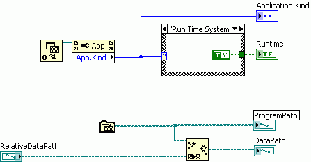

Norbert
I was too speedy. The call chain solution did not work in the real application without the compatibility switch, where the "call chain trick" is in sub VI.
It returns as a "Program Path" the same path as my original VI:
instead of
But why do it complicated, if it works as simple? 🙂
Attached is the VI code in for LabVIEW2009
I hope, this helps
Klaus
Message 18 of 31
(1,956 Views)
It would be a good practice to close the application reference 😉
