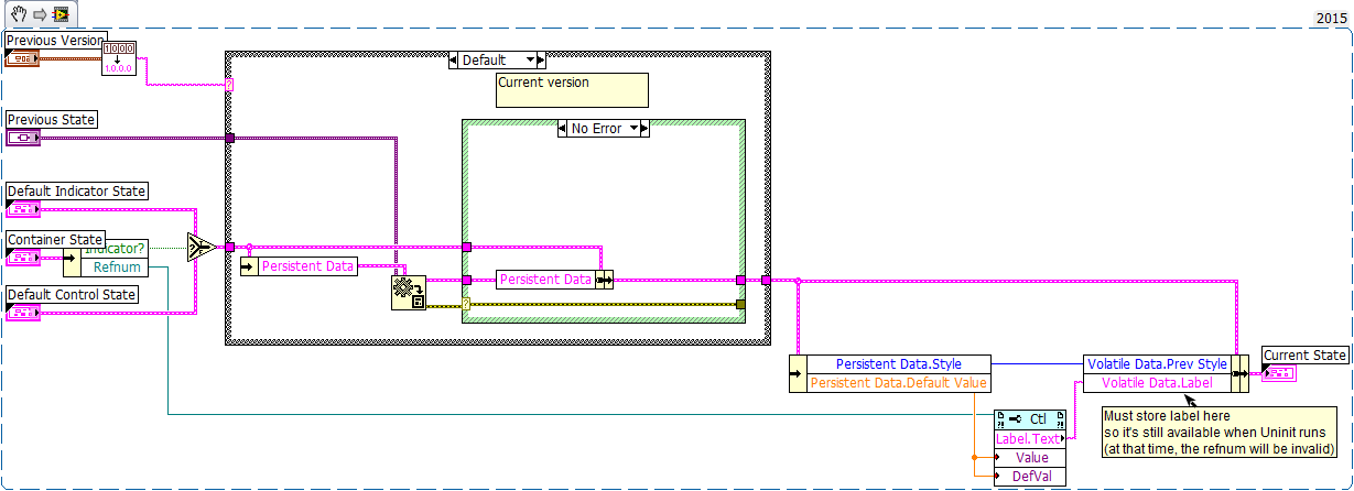

It turns out that the 'Direction Change' event in the Facade.vi is the wrong place to set the default value.
A 'Data Change' event can happen after 'Direction Change', depending on what's going on in the 'Facade.vi'. The correct place to set the default value is in the 'Init.vi'.  Here is the template I use:init.png
