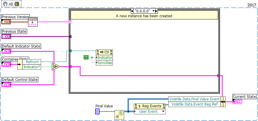

I found the correct solution.  In the Init.vi ability, just set the Synchronous Display property to true.

Seriously, this works?  Do you also have some special INI settings or is a plain old "In the Init.vi ability, just set the Synchronous Display property to true." enough to rid the world of this annoyance?
I've struggled with this on numerous occasions, that's the first time I've encountered that tip (or more accurately since I'm getting older, I don't recall ever encountering that tip before Smiley Tongue).

It does work.  The "annoyance", and the solution, are actually well documented standard behaviors (but I hadn't remembered it and I had to do some digging to find it).
See: https://www.ni.com/docs/en-US/bundle/labview-api-ref/page/properties-and-methods/vi-server/generic/g...
