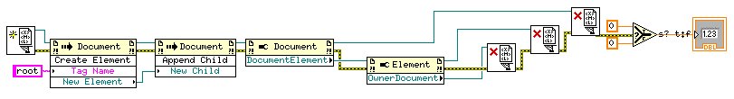

Here's a quick demo of what I'm talking about. There's nothing tricky about it, I don't think... the three closes were attempts to close without a crash, and the crash always happens as I try to close the Document (the select is just tacked on to see if execution gets past the close).

Closing an element whose owner document has already been closed will result access violation. So that is why LabVIEW crashes.  I tried re-arranging the order in which the references get closed and have had your example VI run without crashing.  Just make sure you have the reference coming out of your last property node (the one you close second in your shown VI) close first.

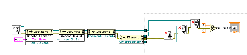

Thanks for giving it a shot, Eric, but your order of closing is the order that I tried first... and it crashes here. Here's a screenshot rearranged that way to make sure we're on the same page:
When it's arranged like this, the crash occurs during the second close, when the DocumentElement reference is closed.
So to recap: closing the DocumentElement ref first lets the OwnerDocument ref close but there's a crash when closing the Document, BUT when closing the OwnerDocument ref first the crash is at closing the DocumentElement ref. To me this shows that closing the OwnerDocument ref doesn't just destroy the reference, but closes the whole Document, leading to a crash from double closure in the first case and a crash from closing something whose owner has already been closed in the second.
