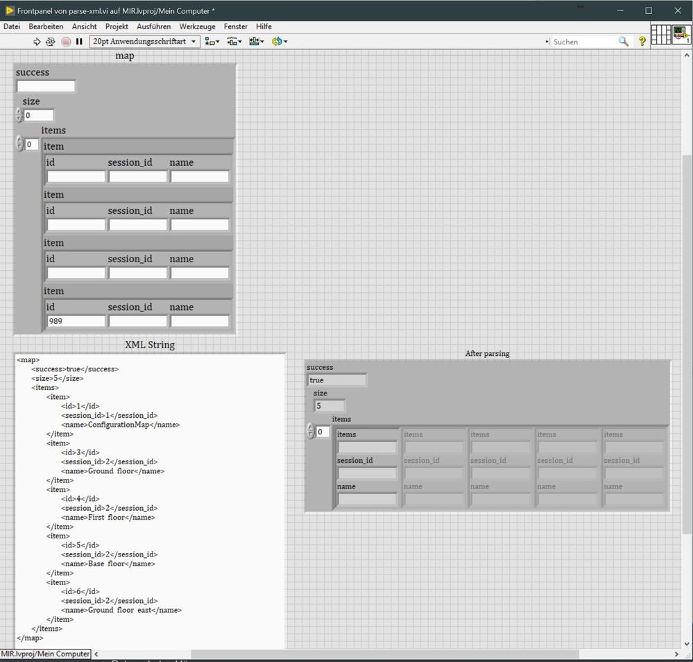

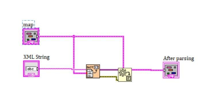

I got some problems with parsing xml strings to Labview.
Im using JKI EasyXML. But i got problems to convert the XML values to an Array. What am i doing wrong?
Please take a look at the attached Vi.

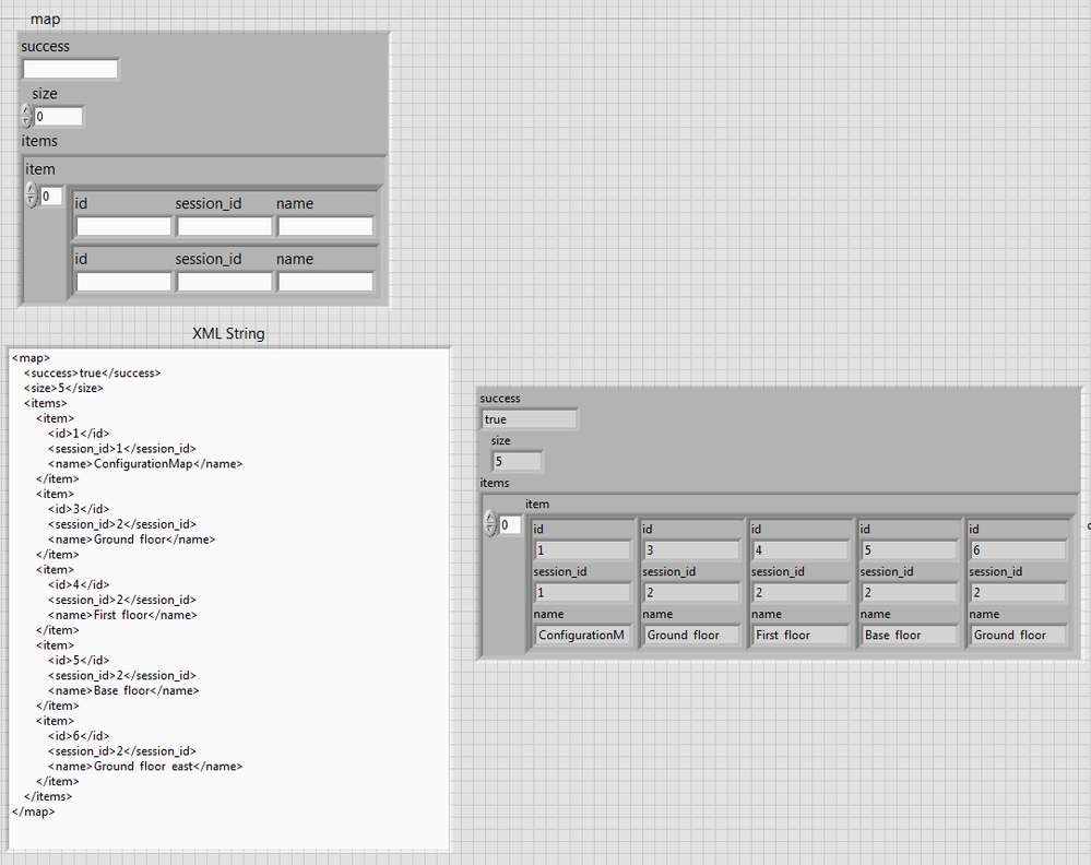

The toolkit works, just update your cluster typedef to include an 'items' cluster around the 'item' array to work with that XML structure.
