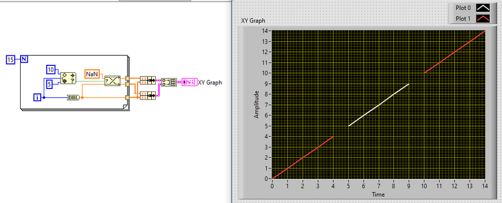

You can't change a plot on the same line to be different colors, but you can make two plots that are different colors, and make parts of them not show up.
The trick is that if one or both of the XY coordinates is NaN, LabVIEW won't draw it or the line connecting it.  So if you put NaNs in your data, you can make it look like a line changes colors.
Here's example code:

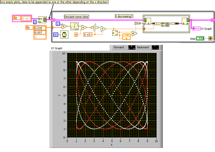

Here's one possibility.
(rough draft: Needs some tweaks to connect all points, for example)

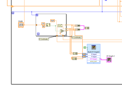

Here is what I have. I do not want to share my entire VI, sorry. I am not sure how make a dumbed down version of it either. I have a "build XY graph" vi and the two XY graphs seem to be following each other. the one pictured is scaling appropriately but not plotting. I am assuming I need to wire the iteration into the array but I am unsure how to do it.
No, that code makes absolutely no sense! Your are just creating a graph that has all the same values, duplicated N times. You need to build the history in a shift register anchored on the while loop and get rid of the FOR loop.
Start with some basic tutorials.

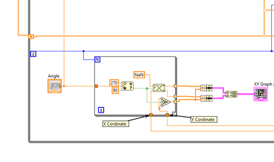

Finally got it working how I need. Thanks all!
Message 7 of 12
(2,363 Views)
This is just plain silly!!! Your FOR loop has absolutely no purpose, it just dramatically increases then number of identical points on the graph. After N iterations, you'll add the new value N times crazily wasting memory!. Get rid of it! (A simple build array can transform a scalar to an array with one element and that's all you need here!). Also note that the first point will never get graphed because N=0 and you get a point at the default value (0,0), which has nothing to do with your data.
Now you are apparently using the build xy graph express VI configured to retain data between calls (we cannot tell from a picture!). You can do exactly the same by building the data in a shift register instead. Much more lightweight!

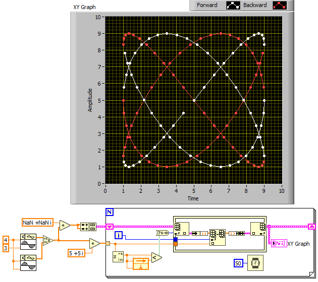

Here's what I would probably do (just change the condition to suit your needs):

Note that my solution only increments one of the plots. Your express VI adds twice as many points (50% NaNs!) for double the memory use. The NaN technique is more suitable for plain graphs.
