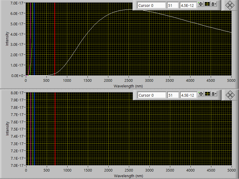

XY Graph y axis range flips when y range max is changed
I have an XY graph whose Y range up/down sense changes when the Y max is changed and the previous Y max becomes the Y min.  I'd like to lock the Y min at 0.  How do I do this?  Thanks

Hi Ted,
Set YMin to zero!
The question is: how/when do you change YMax right now? Why does YMin change when you edit YMax?

  • We would probably need to see some code.
  • Can't you convert your y values to more reasonable units?
  • What is your definition of "flips"? Both pictures show the y axis increasing vertically. No flip.
Well, that's how you programmed it, so fix the code. This is not the default behavior. You have full control of ymin an ymax at any time, so take advantage of that.
If you are operating cursors when the axes change inadvertently, also make sure to disable "cursors scroll graph"
(1,886 Views)
You're right. It wasn't flipping.  It was shifting, dragging the Y min such that the total range remained the same when I changed the Y max.  And you have the fix that works.  The Y values were too 'unreasonable'.  I scaled them by a factor of 10^12 and that appears to have fixed the problem.  Thanks much.
