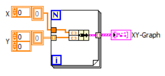

use an autoindexing FOR loop to index your Y 1D data from your 2D array. In the loop you build a cluster of X and Y 1D array, after the autoindexing output tunnel you will have an array of plots for your XY graph…

Hi math,
as I told you:

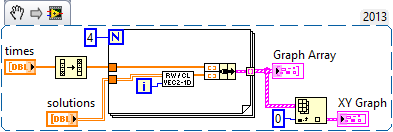

I managed to make it work by doing this:
That subVI just takes the 2d array and outputs a reshaped 1d array from the column vector given by the other input.
Final question, this thing will be part of a VI that runs once every iteration. Is there any way to "concatenate" the graphs of each iteration to show an overall graph?
(7,303 Views)
Also, the reason for using that subVI instead of just autoindexing is that autoindexing a 2d spits out rows, when I wanted columns. An alternate solution would be to transpose the solutions array and just use autoindexing.
