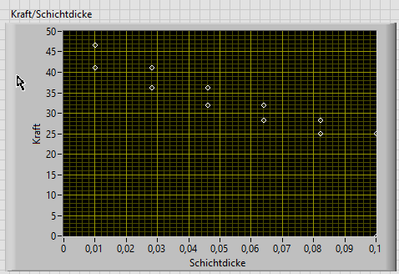

By unwanted double datapoints i mean that the same y-Values are plotted twice, once where they should be and a second time at the next x-Value.
Like seen in this plot.
I can't figure out why i get the point at 0,1/0, the correct one is 0,1/25 and the point at ~0,08/25 is the one which shouldnt be there, ~0,8/28 would be the correct one.
By using the highlight mode i figured out that my Kraft-Value isn't calculated yet while the Schichtdicke-Value is already there and written to the array and plotted, thats where the initial mismatch of 0,1/0 came from.
The same things happens when "Schichtdicke" changes, in the first iteration with the new "Schichtdicke" simply the old "Kraft"-Value is used instead of waiting for it's recalculation.
By following your advice and using wires instead i was able to fix that.
Is there any way to make it look better than wiring across everything? It's just not easy to look at and keep track of.

I was able to get rid off the double datapoints by avoiding local variables where possible.
For cleaning up my wiring i rearranged it a little now and read about using bundle/unbundle to keep it cleaner.
