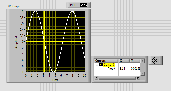

I'm trying to increas the size of the cursor on a XY graph, so it is easier to click on and drag.
So far I've tried using the "Cursor.XScale" property node. But I keep getting error 1077 - "Property Node (arg 1) in Untitled 1"
Is it even possible to change the size of the cursor?

Hi Jacob, You can set the cursor size from front panel by using the cursor attributes as shown in attached image. or you can do it programmatically using the property. "Cursor.Line width" Best Regards Deepu Jacob

The  property "Cursor.Line width" doesn't change the size of the cursor in the crosshair of the 2 lines. Which is what I'm trying to solve. The cursor itself is still as hard to click as before.

This may not be helpful, but surely it is not hard to click on the cursor if you change cursor.line width as in the attached image?

Yes and no.
For the project, I'm controlling the computer with a tablet with teamviewer.
And it is still pretty hard to click/touch the cursor with a finger. And if there are lines, it is possible to click on them and not the cursor which is not intented.

OK, I understand your problem now!
I do not think that the Xscale and Yscale properties of the cursor does determine the scaling of the graphical element that is the cursor. I think it is a property to chose which Scale to use for the cursor. Since you only have one x-scale, 0 is to only possible choice, that is why you get error 1077.
See this thread:
http://forums.ni.com/t5/LabVIEW/Valid-value-for-cursor-xscale-property/td-p/3284914
I do not know how to solve your problem unfortunately...
