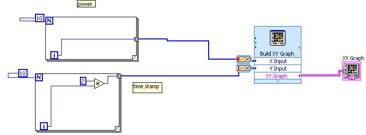

the image get cut . from where you are getting the power values , i mean from the same excel sheet or from some array. for concept varification i make . it has two arrays created from for loops. see the imagespower vs time graph.JPG
it plots all the values power against time

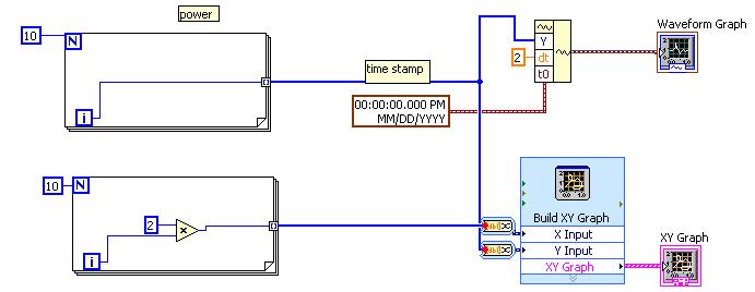

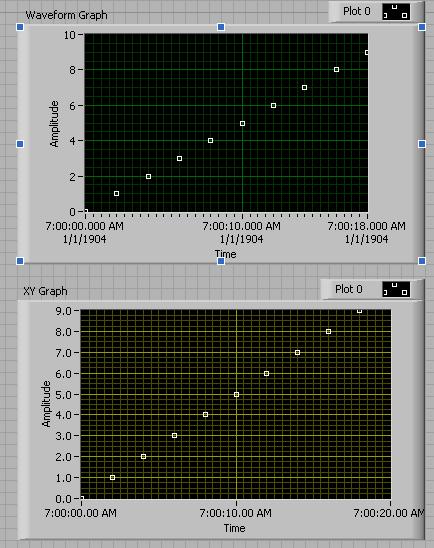

can you know the time difference between each time stamp is it same or variable. if it is same then you take that difference and use the buld waveform utility, the starting time stamp will be the first time stamp. see the pics , i have two options one by making waveform the other one is prev one
