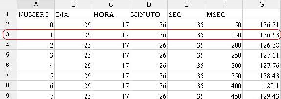

in your thrid entry of excel sheet the time recoded is  150 and the time diff between your prev entry and this is 100 instead of 50 which is followed in all of your excel. so building waveform dt is not exactly 50
