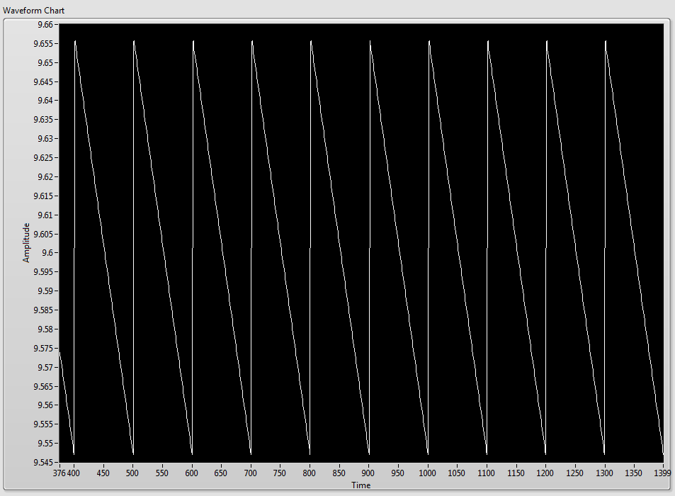

Well yea, but when I build a waveform and use a waveform chart I have gaps in my data. Since Im streaming the same set of data, each time the loop iterate I get a new same of the same data but in between there's an empty space. Also if i change the channel, then the previous channel has to be gone of the display before seeing a full view of the then selected channel.

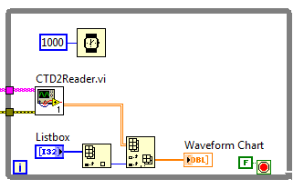

Replace the XY Graph with a waveform chart and wire as shown.  To clear out the previous history, you'll need to detect a change in value of the listbox.  When a change occurs, wire in an empty array to the History property node for the chart.

Thanks for replying but I am alos trying to use the right time stamp for the data im displaying on the plot. Which I noticed you didnt implement in your snipet

Also that technique did not work.
