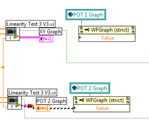

Can someone show me how to fix this?

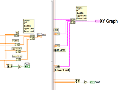

I need the ORANGE "Pot Graph" indicator instead of the purple. how would I change the right block diagram to work?Capture.PNG

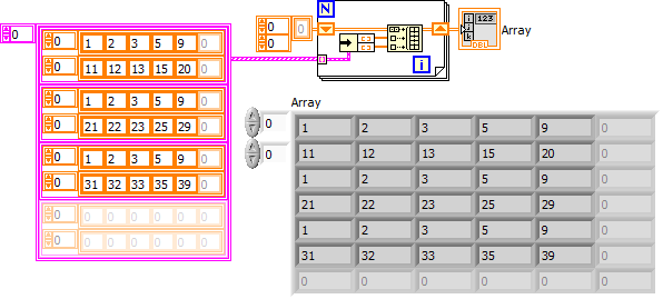

Well, the purple is an array of clusters while the orange is just a 2D array with lots of duplicate information.
To create the orange from the purple, just autoindex on a FOR loop , unbundle, build, and concatenate. Should be trivial.

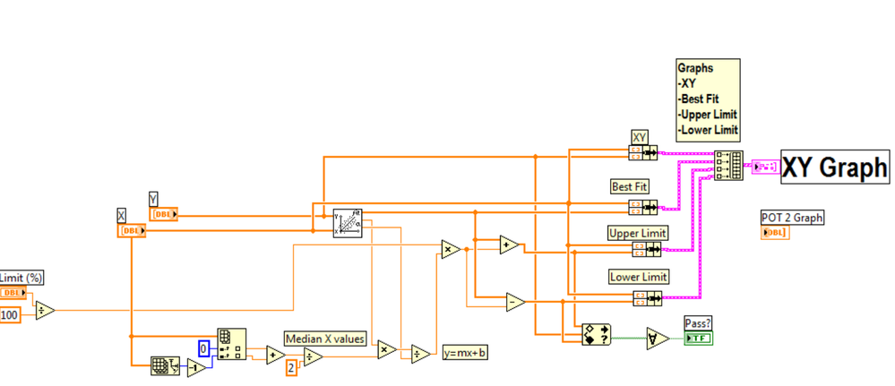

sorry. here you go.
thanks for your help

how do I build it in a 2d array vs. bundling it to a cluster and then unbundle it.
it seems redundant.

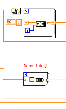

Your ramp generation seems a bit elaborate. Compare here:
To convert the current array of clusters (xy graph data) to a 2D array with the same information according to your old code, just do something like this:
(Of course this "solution" is specific to your data and makes certain assumptions. It might give undesired results, e.g. if the various plots have a different number of points)

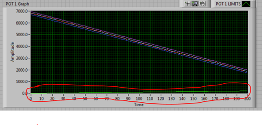

Can you show me how get rid of green line on graph?

These are your X-values. If you don't want them, don't include them in the 2D array!

Awesome!!!
That does the trick!!
THANK YOU SO MUCH!
