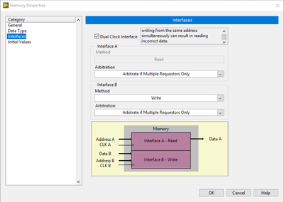

One thing I forgot to mention is that you could also configure LabVIEW Project Memory items as dual clock. I may have gotten too caught up in how you could use the IP Core instead, but this option is definitely easier for the more typical LabVIEW user who doesn't need all the extra options offered by the IP Core. The main disadvantage that I can think of right now is that it's a "simple" dual-clock BRAM implementation rather than the "full" option. That is, it allows read from one clock domain and write from another but does not seem to have any option to read and write from both domains.

Thanks. The dual-clock option I already have used a lot.  It's mostly the combination between that and different width read / write which I could have used recently.  Instead, I needed some hoop jumping in order to overclock a producer loop on FPGA x2 in order to support a function which would have been more elegantly (and with less resources) solved with different width read / write ports.
